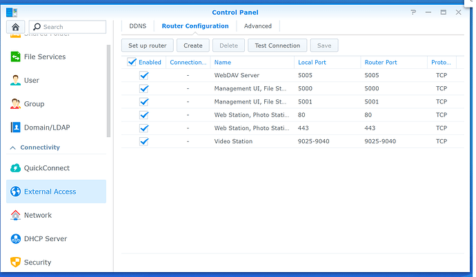

You set a server url with port 5000.
I think you are using Synology NAS. If it’s right, please set port 5005.

This is the setup for ports that I have.
Yes, you should set the url with port 5005.
