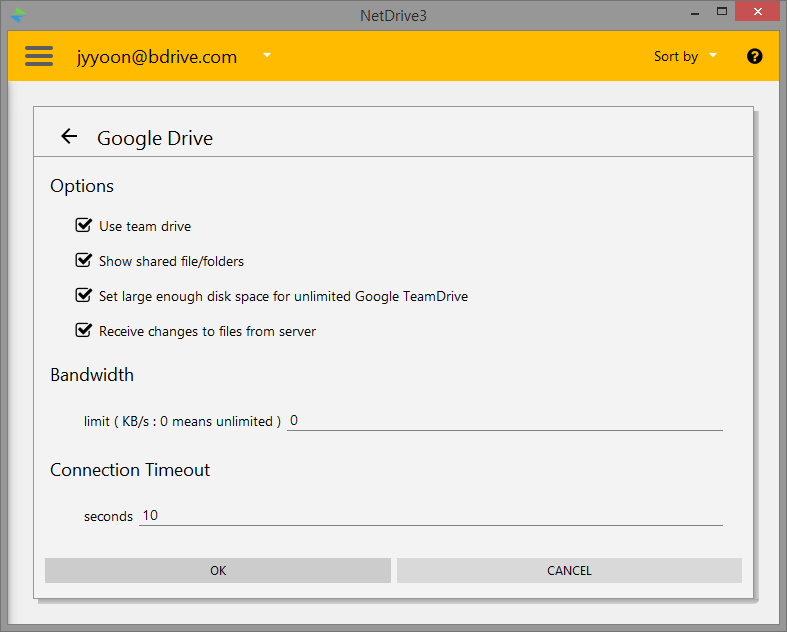

If the issue persists even though register your own api key, turn off “GetChanges” option in “OPTION” of the drive item configuration.

I would like to avoid turning off “Receive changes to files from server” as this is a great feature

If “Receive changes to files from server” is on, it calls the API every 5 seconds for changes.
This is the cause of the API limit.
If you’re using Google Drive alone, we recommend turning it off because it’s meaningless to get server-side changes.
