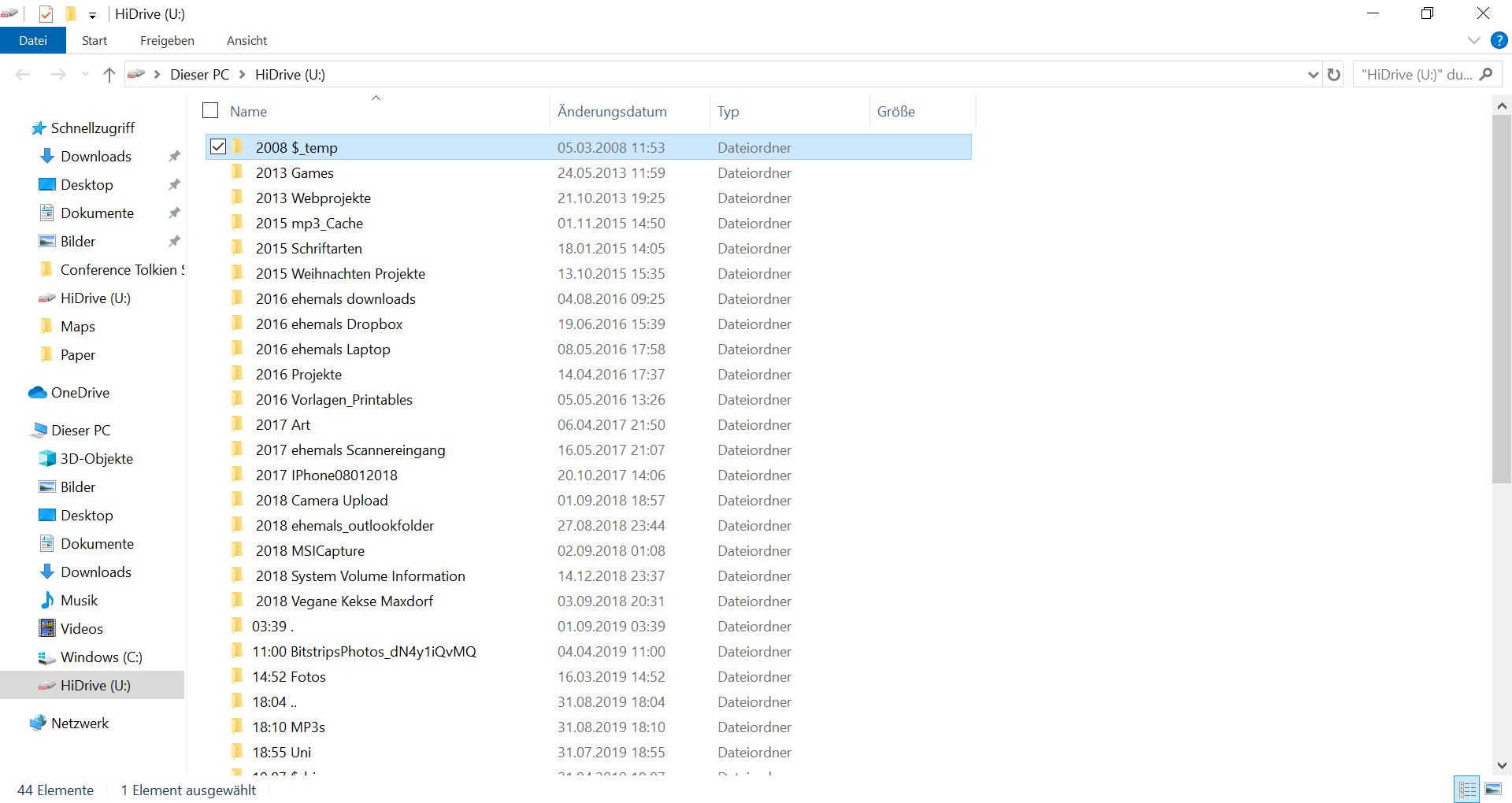

I’ve also sent you the asked logfiles and additionally attached further screenshots of the folder/files I was trying to click to or access to while VERBOSE logging.
Hello, attached to this mail you’ll find the asked VERBOSE logfiles as ZIP archive. I’ve also attached screenshots in chronological order as I was clicking in explorer while VERBOSE logging. You can clearly see, that NETDRIVE3 now since the update append the date and/or time of a file or a folder to the filename/foldername which results in access errors. For example the folder displayed as “2008 $temp” is really named as “$temp” on the SFTP server connected. The misbehaviour appeared directly after the last update at August 30 / August 31.

Hello customers.
I found a problem with incorrectly parsing a list of files from the log you sent.
I will fix this issue as soon as possible and let you check it.
@m-schneider
Hello Michaela.
The cause is an incorrect parsing of the file list.
For example, the server responds with the following.
drwxr-xr-x 6 1000 1100 10 Apr 6 2017 Art; 1491508234
Previously, the server would have responded with a user account rather than 1000 or 1100.
This is because NetDrive recognizes 1000 and 1100 as file sizes.
We will fix this problem.

Hello e317-info
I got the file you attached.
There is no file list datas in you log file but I guess your issue is a same thing with m-schneider’s
If you can contact admin of your server, fix user account to show account name in directory list.
Example:
drwxr-xr-x 2 1000 1100 2 Sep 1 2018 Camera Upload
drwxr-xr-x 2 account account 2 Sep 1 2018 Camera Upload
Then your issue will be solved.
Of course, NetDrive will also be fixed for this issues.

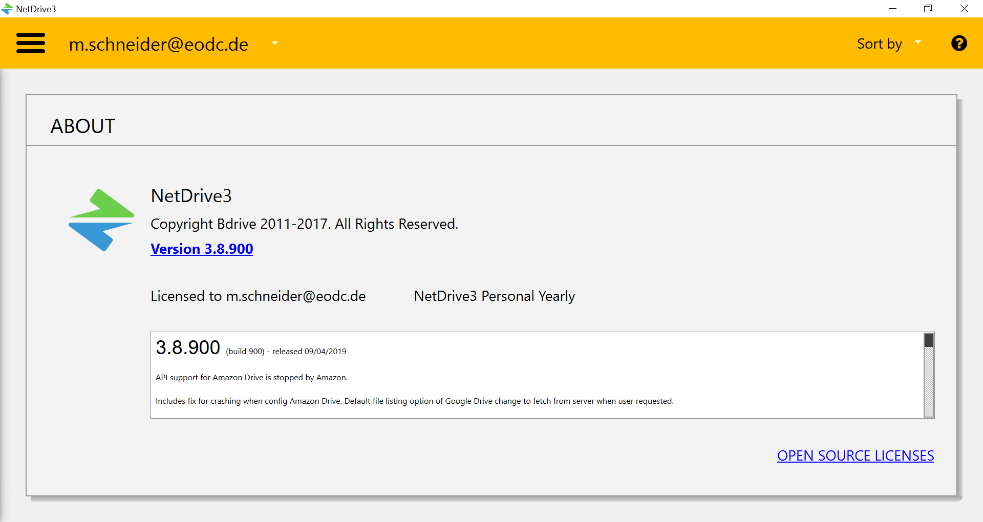

Hello, same here. First I updated to the link postet here which resulted in Version 3.8.898 and rebooted. Then I’ve got the same result as @e317-info . Some folder were correctly displayed, some not with the year of the file date attached again.
But wait for this: after reboot I’ve got the message, that again a new version is avaiable 3.8.900. First I waited unsure if the previous fixed worked and I skipped this update to see the result. After realizing, that the patch link posted doesn’t solve the problem I manually updated by downloading from the website NetDrive | Mount your storage as local drive. After installation and reboot I’ve got 3.8.900 now.
Look at this result: now the drive is displayed as empty although connected to the SFTP server with FileZilla everything is fine. As a paying customer the promised SFTP function is essential for me. WebDav is not really an option as we need exact file date time recording when copying files between cloud and local storage which is correctly provided via SFTP & the Strato HiDrive service. Additionally SFTP is needed due security issues.
