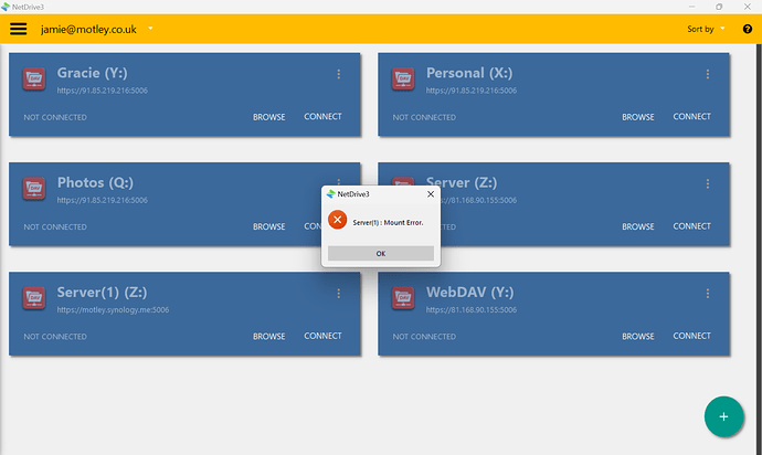

Have recently not been able to connect to my Synology NAS and when I try to connect in Netdrive I get a pop up ‘Server: Mount Error’
In config > connect, Netdrive appears to connect ok and when I click on browse, I can see the folder structure. IKts just when I click connect to add it as a mounted drive that the problem starts.

Could you please upload a screenshot of the issue and log files?
Please be aware that the log file does not contain any login credentials.

Hi there
I think I have done the logs as requested - please find attached a zip and image

Dear jamie1,
Thank you for providing the log files for analysis. However, it appears that the ‘nd3svc_Server(1).log’ file is missing from the files you submitted. We observed attempts to mount ‘Server(1) Drive Item’ from the screenshot and ‘nd3svc.log’, but we will need the associated ‘child service’ log file for a thorough analysis. If you could please attach the ‘nd3svc_Server(1).log’ file, it would greatly aid in diagnosing the issue.
[2024/05/13 08:18:58.037] [DEBUG   ] [    7520] [SERVICE   ] execute_child succeeded : "C:\Program Files (x86)\Bdrive\NetDrive3\x64\nd3svc.exe" -c _2 "Server" [c:\buildbot\slave-win\netdrive3_release\netdrive3_sdk\nd3svc\parentpipe.cpp:68]
[2024/05/13 08:18:58.267] [DEBUG   ] [    7520] [SERVICE   ] CParentPipe::Init:: pipe \\.\pipe\nd_mount_2 is created [c:\buildbot\slave-win\netdrive3_release\netdrive3_sdk\nd3svc\parentpipe.cpp:506]
[2024/05/13 08:18:58.268] [DEBUG   ] [    7520] [SERVICE   ] CParentPipe::Init:: pipe \\.\pipe\nd_mount_2 is connected [c:\buildbot\slave-win\netdrive3_release\netdrive3_sdk\nd3svc\parentpipe.cpp:514]
[2024/05/13 08:18:59.165] [ERROR   ] [    7496] [SERVICE   ] MsgProcessor::Mount:: failed to mount. label: Server(1), pipe: \\.\pipe\nd_mount_1 [c:\buildbot\slave-win\netdrive3_release\netdrive3_sdk\nd3svc\msgprocessor.cpp:202]
Additionally, installing the latest version of NetDrive could potentially resolve the issue. You can download the latest version from the following link: Download NetDrive Latest Version
We are committed to helping you resolve this issue. Please feel free to reach out if there’s anything more we can assist you with.

Dear jamie1,
I found a error in the file you attached. Some program like as anti-virus or anti-malware program could banned installing the filesystem of NetDrive.
[2024/05/14 08:06:52.656] [CRITICAL] [   11320] [FILESYSTEM] NetDrive filesystem does not installed
It can be blocked by some programs like Antivirus or Anti-malware softwares. If you use these softwares please unblock or add exception.
If you are not using any antivirus software you can try re-install NetDrive filesystem driver.
  • Open Command Prompt as Administrator
  • Change directory to C:\Program Files (x86)\Bdrive\NetDrive3
  • syshelper.exe i cbfsinst.dll cbfs.cab NetDrive3 "C:\Program Files (x86)\Bdrive\NetDrive3"
  • If syshelper.exe displays 0 the installation succeeded.
  • Otherwise, the installation failed.
Regards
Many thanks - re-installing the driver seems to have fixed the issue!
