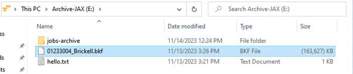

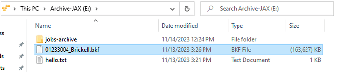

– If I try to copy files larger than 2 GB (like the 3.8 GB one for testing using normal drag-n-drop or robocopy etc) it fails with those previous errors I sent in the start of this topic. However the File Explorer in Windows shows the partially copied/failed file with the size in parenthesis like so: “(2,097,151) KB”. No matter what large file I sent, the same thing happens with the same KB shown in parenthesis. Also, as previously mentioned from that last screenshot you’ll see how NetDrive’s upload shows the size as (x,xxGB/2.00GB) while copying.

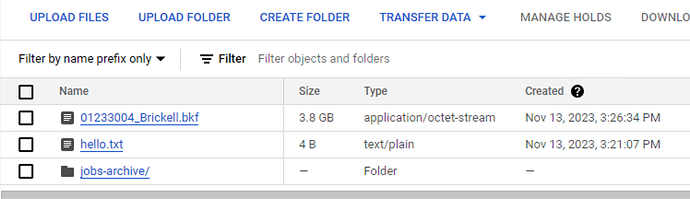

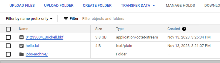

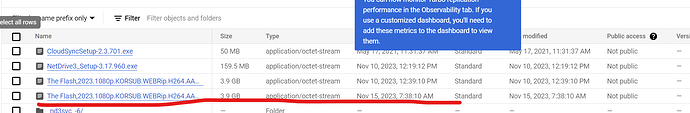

– Interestingly enough, if I used Googles gcloud CLI application then it successfully sends the full 3.8 GB file over. However, oddly it reports the size like show in File Explorer: “(163,627) KB”. But if I check it from within the GCP console it shows it correctly as 3.8 GB. I’ll send the logs next.

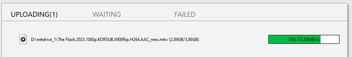

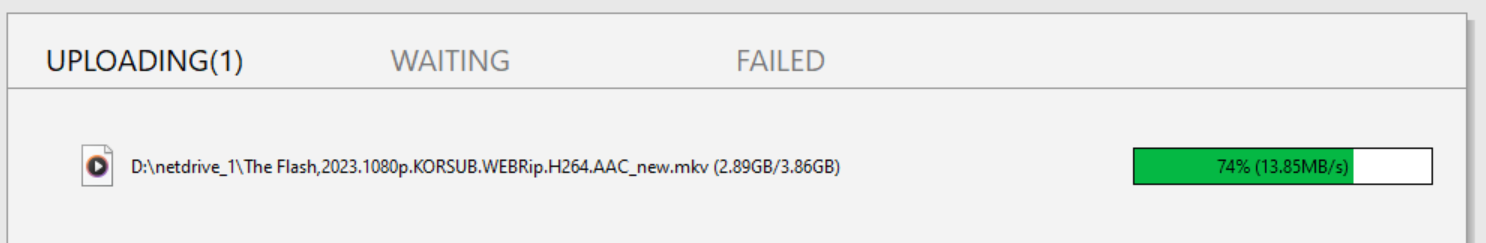

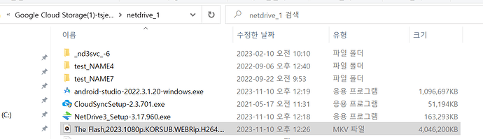

That’s strange, I just connected to Google Cloud Storage with S3 Compatible and tested uploading with a file of about 4GB.
But it uploaded without any problems. The screenshots below are of the upload progress, the completed upload in Windows Explorer, and the uploaded file from Google Cloud Storage.
My question is, do files smaller than 2GB upload normally?

Also, interestingly no matter if I have it mount as a local drive or network drive its unable to show the correct sizes in the File Explorer file listing if a file is greater than 2GB. The GCP Console shows the full size correctly.

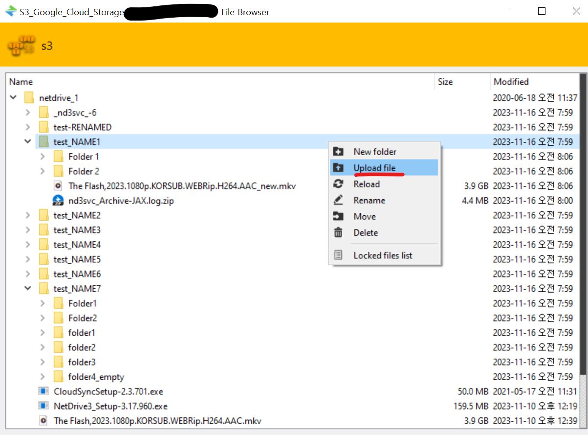

And I’m testing on Windows 10. Can you also try uploading a file larger than 2GB in NetDrive’s File Browser? If it uploads normally in NetDrive’s File Browser, it’s likely a problem with Windows File Explorer.

Hi there. Two things discovered so far:
a) I get the same errors and issues when testing a newly made Windows 10 Pro 22H2 VM with the S3 storage type in-use.
b) NetDrive’s File Browser works on Windows 2022 and the Windows 10! :slight_smile: Thus I can upload files larger than 2GB and see the correct file sizes.
