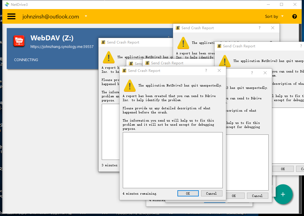

Unable to connect through Webdav to synology on Win 10 64bit. Erro window appear “Authentication with WebDAV has failed”

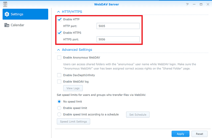

I think the port number of the server url you set in NetDrive is not for webdav but http(https).
Please check again which the port number is for webdav you set in DSM(or port forwarding).
And even if the port number is not for webdav, the crash should not have been happened.

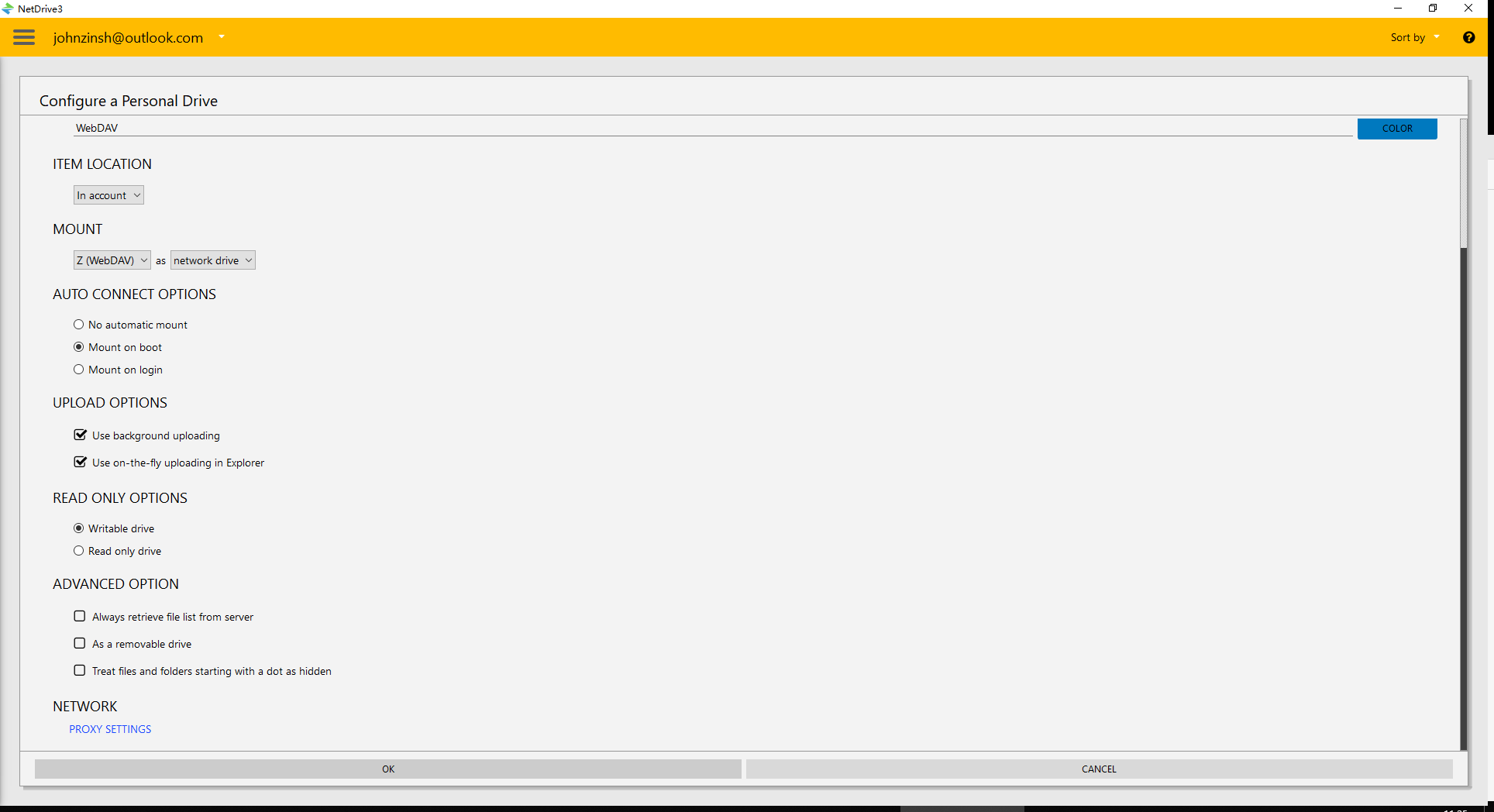

I reviewed the files you attached.
You must set the webdav server url to https://johnzhang.synology.me:5006.
“https://johnzhang.synology.me:59557” is not a webdav url but a http server url.
Please set “https://johnzhang.synology.me:5006” the server url, then you can see the files and the folders.

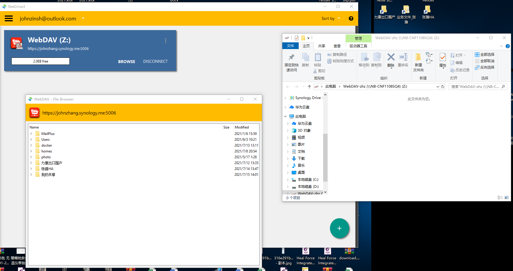

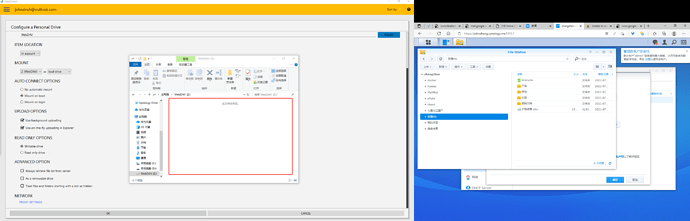

i can see something in the browser of netdrive but still nothing in my local drive
Dear johnzinsh1,
It’s a weird.
Could you attach debug log files one more time?
