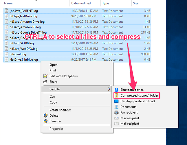

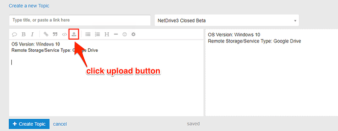

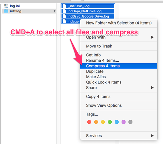

I have 5 log files, which one?
Dear it16,
Select all the generated log files and compress them into a Zip file and send them to us.
If your web browser does not support drag and drop of the file. Please click the upload button and select the file:
