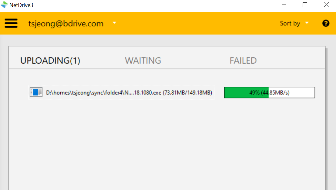

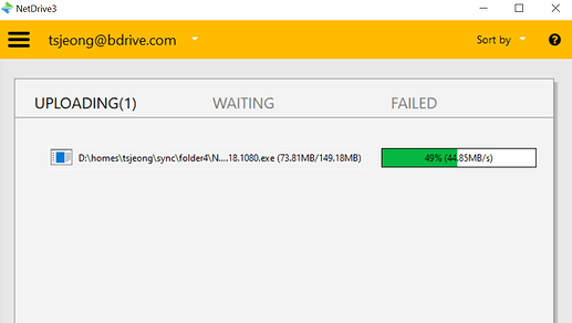

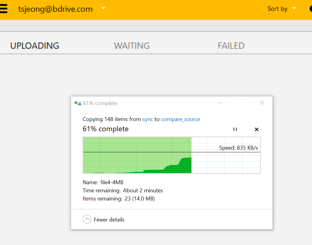

We have tested the same scenario using NetDrive version 3.18.1125, copying both 148 small files and a single large file, and the results showed normal transfer speed in our environment.
  • Small files: ~835 KB/s
  • Large file: ~44.85 MB/s

  3. Overhead from small files – FTP can be less efficient with many small files.
