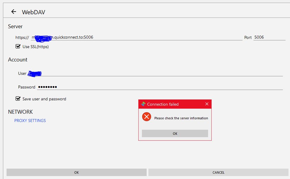

I am attempting to setup a connection to a Synology NAS using WebDAV as described on the Synology website. They suggest using NetDrive. I have Netdrive 3 installed, account created and attempting to setup my first connection to the NAS. My goal is to map a network drive via NetDrive for use away from the home office. I CAN connect to the NAS using a browser through HTTPS and get logged in to it. When I put those same address and credentials in NetDrive and try to connect all I get is “Connection error” (see attached screen shot). The only thing I see different is the PORT. The browser connection (using HTTPS) does NOT use a port number, but the WebDAV settings on the NAS indicate to use port 5006, so that is what I entered in NetDrive. NOTE: NetDrive will NOT let you leave the Port field in the connection settings window “blank”.
HELP! I am on the trial period, and if this isn’t working at the end I will discontinue NetDrive and look for another solution. THANKS IN ADVANCE!

attached are the log files from today’s attempt to connect to the remote drive. As was true last week, I CAN connect directly to the drive thru a browser, but I am unable to create the connection in “Add Drive” window in NetDrive.

I got your log files.
I found “Couldn’t connect to server(7) treat as Unknown” error in the log.
I think it was caused by a network environment or something else.
Is your browser set under proxy?
Or the following topic may be helpful to you.
Please check user setting or block list.

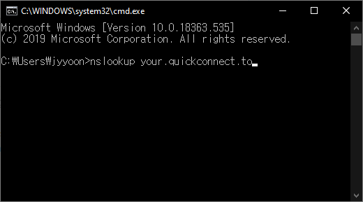

Could you check your ip of your NAS?
Then execute a following command in your console.
nslookup your_domain_of_nas
I think it will return global ip of router not your NAS.
If my guess is right, you need to set port forward for 5006 port.
