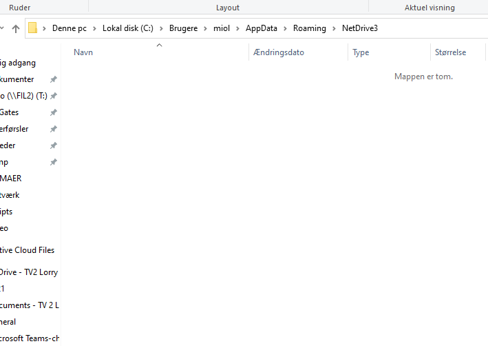

Please check if there is a file named core.dat at C:\Users\miol\AppData\Roaming\NetDrive3 and it’s permission. The executable nd3cmd.exe tried to open the file but failed.
this folder is empty see attach picture
This time please upload log files while using user name and password. From the log file I cannot find disconnect command is passed to the NetDrive system service.
Sorry for the confusion. “core.dat” file is created only when you set “Keep me logged in” option set.
When there is no core.dat file nd3cmd will retrieve necessary information from accounts server using user name and password.
