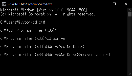

Or could you try below command with above files I attached.
In the installed path [c:\Program Files (x86)\Bdrive\NetDrive3]
ndagent.exe -d
Then you could see a error message.
Please let me the message.
It says it’s missing MSVCP140D.dll VCRUNTIME140D.dll ucrtbased.dll then MSVCP140D.dll again. I’ve installed the latest Visual C++ Redistributable already, but the message doesn’t go away.
