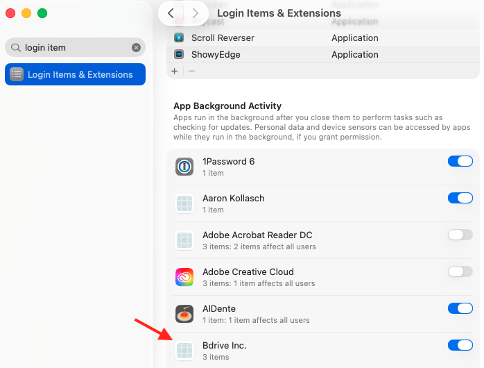

If the kext loads successfully, the issue is likely related to it not being loaded automatically at login. In that case, please ensure that Bdrive Inc. is allowed under System Settings → Login Items & Extensions.
