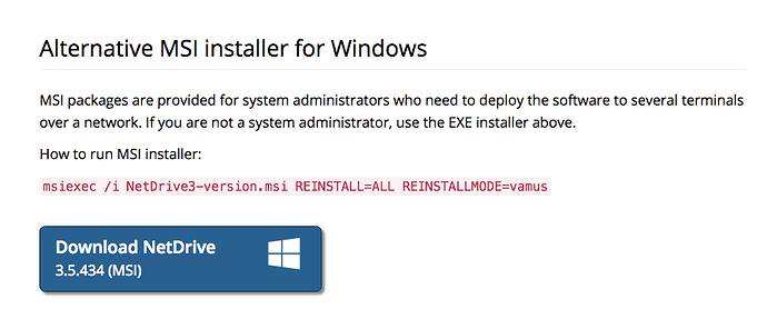

As a follow-up here.
The only way to install/upgrade on windows server 2016 is to extract the contents of the installation package then:
  1. Remove existing installation of NetDrive 3 without a reboot
  2. Install new version from MSI package
  3. Reboot is then optional but recommended.
You can download MSI package at the bottom of download page.
