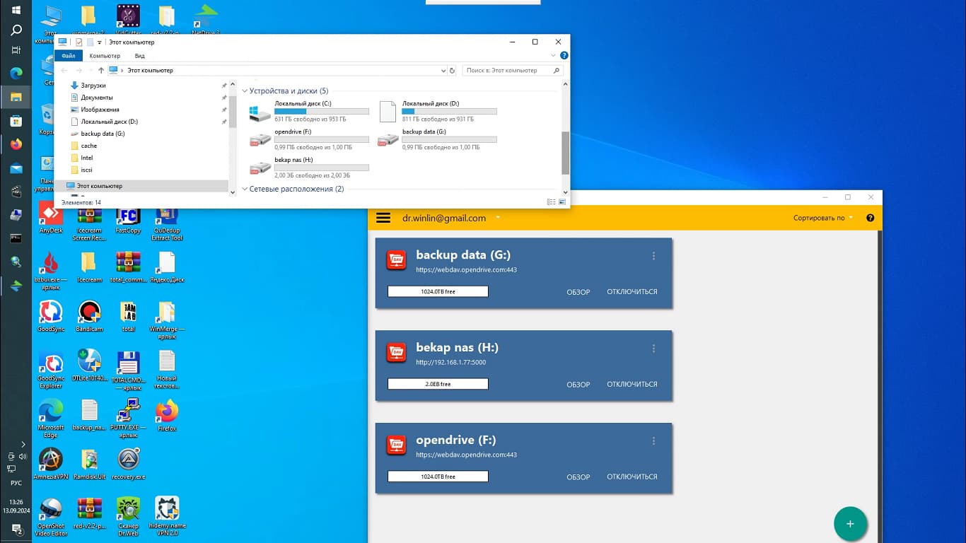

Thank you for the answer. But in the proposed example, the connection goes as a network disk. In this form, the application from BackBlaze does not see the comedy discs, it sees only local wheels.
I need to turn the network disk into a local one. Netdrive can do this, but it doesn’t seem to work to the end, it works somehow in its own way. It is necessary that the network disk be like a local disk with a NFTS file system. This allows you to make the Stable CloudDrive program. I managed to achieve the desired result using two Netdrive and Stable Clouddrive programs. But I wanted a similar effect using one program, Netdrive

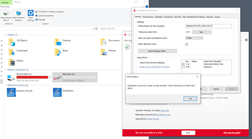

I tested using Backblaze Computer Backup, and here’s what I found:
To perform a backup using Backblaze Computer Backup, a folder named ‘.bzol’ must be created. However, when WebDAV is mounted to the root directory, it is not possible to create the ‘.bzol’ folder (as shown in the screenshot below). This occurs because NAS systems typically prevent the creation of folders at the root level, so it is not possible to create a folder freely at the top level of the NAS.
The solution is to set the Remote Path to a subfolder, not the root, when creating the Drive Item in NetDrive. By mounting it as a local drive in this way, you should see that Backblaze Computer Backup can successfully create the ‘.bzol’ folder (as shown in the screenshot below).
Please refer to the attached screenshot for further details.

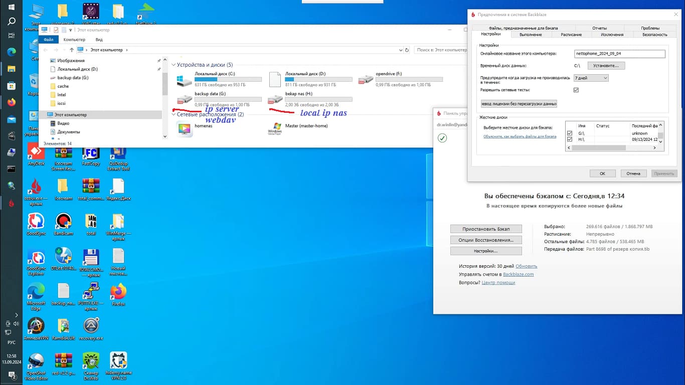

I conducted the following test:
I created a drive item in NetDrive and connected it as a local disk (D: drive).
Then, I downloaded and installed the Backblaze Backup software. The Backblaze Backup program automatically recognized both the C: and D: drives and successfully initiated the backup process. I have attached a screenshot of the results.
This demonstrates that it is possible to create a local disk using NetDrive and perform a backup with Backblaze.
Hello, tsjeong!
Yes, with local servers, everything is ok, I also tested it.
But with outside servers, glitches, in particular, I use the Opendrive.com service according to the Webdav protocol, I’m struggling with it, I try again on the new version of Netdrive (3.18.1111), I put it today, I’ll see it or not.

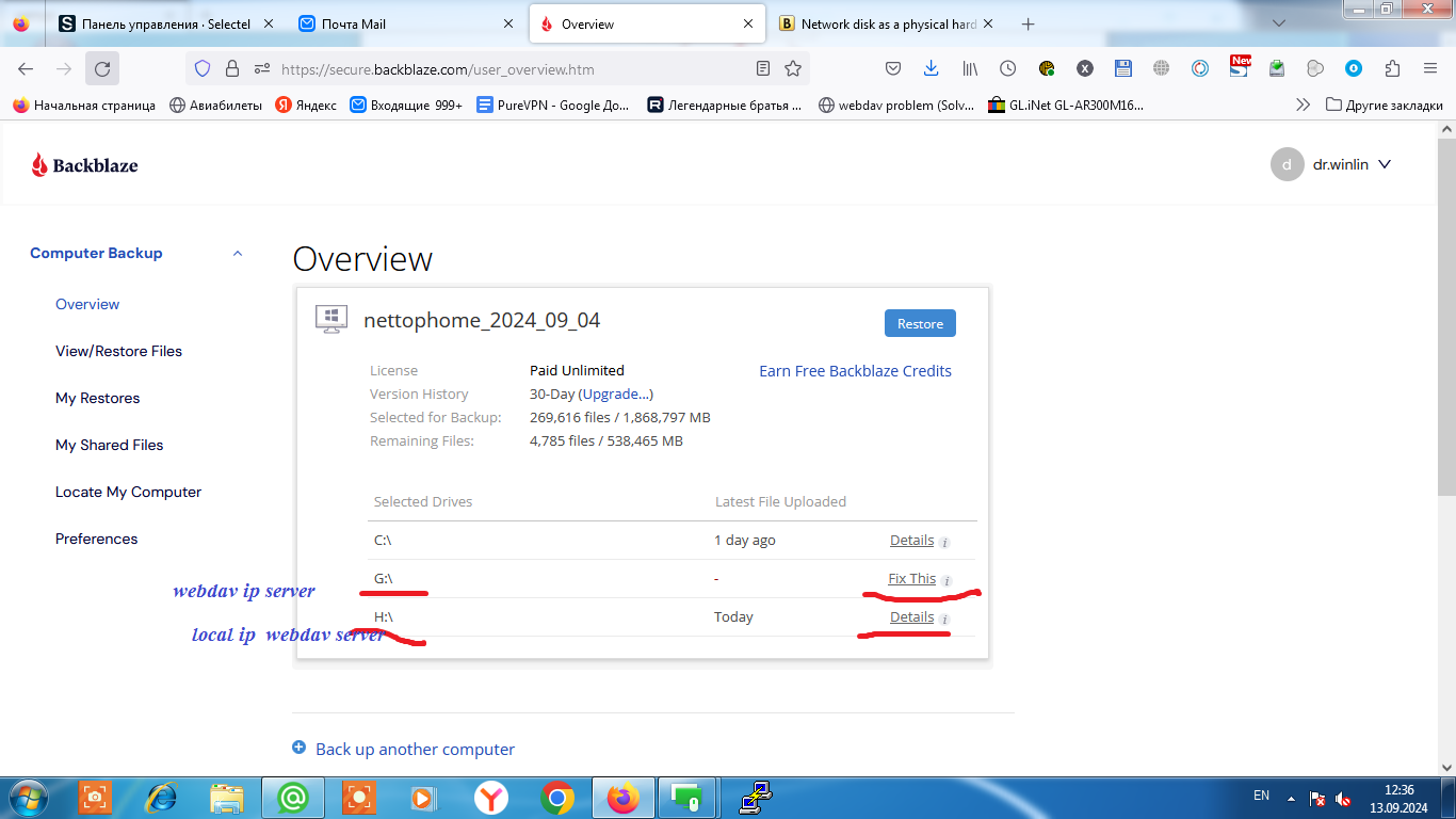

local_ip
Backblaze downloaded, via Webdav.
