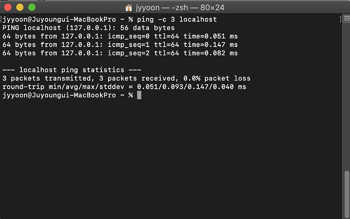

You can check it in a Terminal.
ping -c 3 localhost
Please confirm that the bytes are from 127.0.0.1 not not.
Or ping could be failed if the IP of localhost is changed by hosts file.

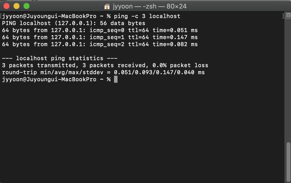

These are screenshots of what shows after we have completed those steps. What do you recommend I do next?
Your mac was not able to resolve localhost.
It seems that localhost is set to a different IP in the hosts file.

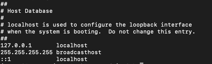

You can show the hosts file’s contents with a following command in terminal.
cat /etc/hosts
Below is default hosts file’s contents
I think your hosts file is modified by some reason.
You can add 127.0.0.1 localhost to hosts file.
