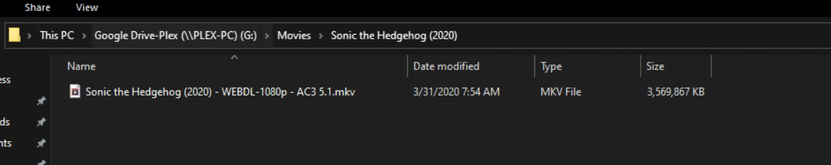

PC:1 - Where the movement of files occur.
As you can see in this image the file is the movie with 5.1 surround.

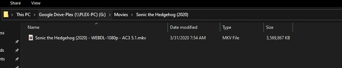

PC2 - Home PC w/ Plex
In this image the file scans in correctly and the script is working at this point.

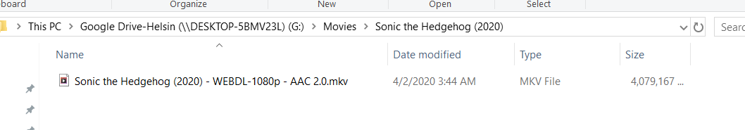

PC:1 - I now remove the file and add in another file to substitute it.
In this image you can see the file is the movie has 2.0 sound.

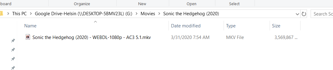

PC2 - after running script
As you can see in this image, after running the script, the file is not updated from PC:1, it is still showing the 5.1 Surround file.

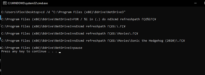

I included a image of the script to show what the script is outputting.
Script contents:
cd /d “C:\Program Files (x86)\Bdrive\NetDrive3”
FOR /D /R G:\ %%i in (.) do nd3cmd refreshpath “%%i”
I think there are garbage string in the command.
Could you try againt without the garbage strings?
